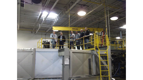

Transmet Corporation, a specialty manufacturer of blast media for castings, paint removal, and automotive component remanufacturing, reported it has expanded its cast zinc shot production operation, a project that focused on the means of collecting and classifying cast zinc shot for packaging. The company noted that the expansion and improvements will make it possible to increase production of cast zinc shot material, and improve operator safety.
Transmet indicated the improvements were financed internally, aided by a grant from the Ohio Bureau of Workers Compensation. Columbus-based Applied Engineering Solutions designed new equipment. Specialty machining was done by Crist’s Machining in Lancaster, OH, and H.I.P. Mobile Welding, Stoutsville, OH, carried out the project installation.
