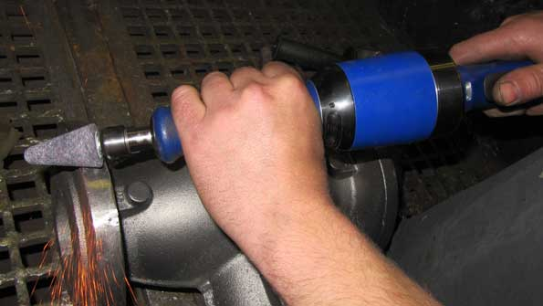

“Our customer, a well-known manufacturer of cast iron pump housings, requested that we re-examine their working procedures to find out where they might optimize,” Dr. Hubálek recalled. “First of all we analyzed the current situation on site. It was important not only to inspect the grinder but also the abrasive used in the customer’s application.”
The customer had been able to reach a maximum grinding speed of 32 mps. Upon closer inspection of the technical details, the Deprag techs discovered that an abrasive was being used that allowed a maximum speed of just 15,000 rpm. To process cast iron parts the pump manufacturer had opted for a straight grinder with a Deprag GDS100-190BX vane motor. The grinder’s 1-kW power output and 19,000-rpm idle speed had been the right choice for the previously used abrasive.
Deprag’s product line includes grinders with collets in power ranges from 90 to 1,200 W, at idle speeds of 11,000 to 100,000 1/min. These are available in straight or angled design, and it also offers radial grinders with power ranges of 500 W to 2,400 W, at speeds of 4,000 to 17,100 1/min.
After the inspection, however, Deprag’s technicians undertook a deeper analysis. “Our goal is to increase productivity,” according to Hubálek. “This is basically attained by increasing the grinding speed. For optimal processing of the cast iron parts we selected the straight-design grinder, GDST100-280 BX with power output 1 kW and idle speed 28,000 rpm for the customer,” he continued.
In order for the turbine grinder to be effective a suitable abrasive is required too, one that is compatible with the higher grinding speeds. The application technicians at Deprag recommended an abrasive capable of speeds up to 29,800 rpm, almost double the speed of the abrasive previously in use.
“However our customer was not well pleased when he first heard the cost of this higher-quality abrasive,” Hubálek recalled. “It seemed to him that the unit costs were much too high compared to the previously used cheaper abrasive.
“But, it is not as simple as that,” he continued. “Whether a solution is economically viable is proven in field tests. This field test was carried out with the turbine grinder and alternative abrasive on site.”
A grinding speed of 47 mps was achieved using the new turbine grinder, 46% faster than previously achieved in this application. More than that, “this field test proved that the change to a turbine grinder not only saved processing time but also that the new abrasive lasts four times longer. The customer had not initially evaluated the increased lifespan of the abrasive,” Hubálek explained.
He related these facts in comparison to the customer’s current operations. Working in two shifts and processing 1,500 cast iron parts per week, the previous grinding routine was incapable of maintaining sufficient throughput without resorting to overtime. “But, due to the faster processing of the GDST100-280BX turbine grinder, and corresponding abrasive, so much time is saved that overtime is no longer necessary,” he reported. “Together with the four times longer service life of the abrasive, the cost comparison shows a total savings of over 30%.”
