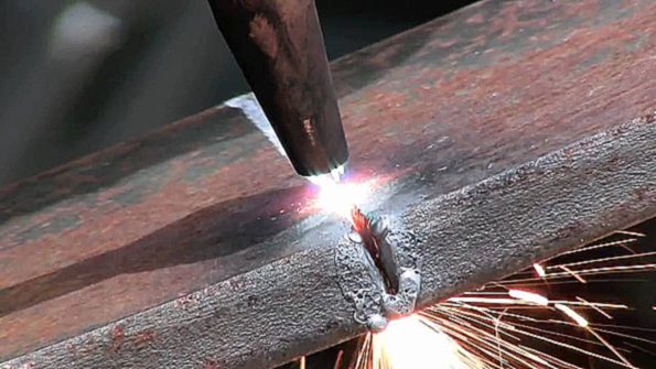

AB&I Foundry in Oakland, CA, has adopted an alternative, hydrogen-based welding gas for material repairs and fabrication projects. MagneGas fuel is produced by the patented MagneGas process, which converts liquid waste into a hydrogen-based fuel.

In 2014, the developer introduced a second formulation, MagneGas2, described as “a rich mix of gases” that achieve a lower flow rate and a flame that behaves like standard cutting fuels (e.g., acetylene), which reduces the need for retraining.
The developer claimed MagneGas2 cuts faster than acetylene with significantly less oxygen consumption. Independent comparisons showed that the gas cut 38% faster than acetylene on 2-in.-thick carbon steel, and with a 34% reduction in oxygen consumption. Even better results were claimed in comparison to propane, though those figures were not released.
