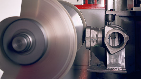

For many years automatic grinding was a solution that only high-production shops could consider, because of the consistency of the sizes and types of castings they produce. Now, the technology has advanced to allow job shops to take advantage too. Suppliers have responded to the needs and desires of foundries with upgraded systems that are more user-friendly, reliable, flexible, and versatile. Adaptations to the equipment and technology over the years now allow very quick change-overs, ease of operation, simplified off-line programming, lower maintenance, and shorter cycle times.
Suppliers of automated grinding system have updated their offerings to be more user-friendly, reliable, flexible, and versatile.
