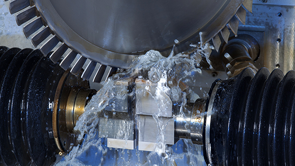

Electrochemical machining — or ECM, in which cathodes are used to remove imperfections from the surface of a workpiece, is commonly used for finishing parts needed by aviation and aerospace, automotive, toolmaking, medical technology, microsystems engineering, energy systems, and other manufacturers. It’s compatible with high-volume operations.
This procedure makes deburring possible in difficult to access areas, such as internal bore intersections and pockets, and also permits burr-free shaping processes. The machining tool, namely the cathode, and the component (as an anode) are connected to a generator that serves as a direct voltage source for the machining process. The component is machined accurately, independent of the metal’s amorphous structure, by means of the charge exchange that takes place between the cathode and the anode in an aqueous electrolyte solution. This makes it possible to produce even very small, thin-walled contours, fillets, ducts, slots and washouts in workpieces made of practically any conductive metal.
Since processing is contact-free, the tooling is neither subject to wear due to the machining process, nor is it exposed to thermal or mechanical influences.
The characteristics and the shape of the tool holder determine where and how much material will be removed from the workpiece. Generator power is selected according to the size of the surface to be machined at any given point in time, and also determines the speed at which material is removed and the achievable degree of surface roughness. Newly developed generators reach Ra values of 0.1 µm and better, depending on the initial state. Beyond this, they also prevent so-called stray machining, which may lead to worse machining results at the anode’s peripheral areas.
ECM and precision electrochemical machining (PECM) are based on the same principle. Essential differences include the distance from the cathode to the workpiece on the one hand, and the use of an oscillating cathode in the PECM process on the other hand. Similar to electrical discharge machining (EDM), this makes it possible to produce extremely accurate three-dimensional shapes, contours, and structures with very high levels of surface quality. Ra values down to 0.03 µm can be achieved.
Compared to EDM, the PECM process is more accurate with regard to component dimensions and tolerances, and it imparts no thermal effects to the workpiece. Significantly reduced machining time is a further advantage of PECM, as opposed to conventional manufacturing. Comparisons, for which a component was produced by means of a conventional process involving spark erosion, milling, drilling, grinding, deburring and lapping, as well as a PECM process with subsequent grinding, reveal a 90% reduction in pure manufacturing time. In addition to shaping, PECM is used for micro-structuring of surfaces, for example in order to optimize tribological properties.
