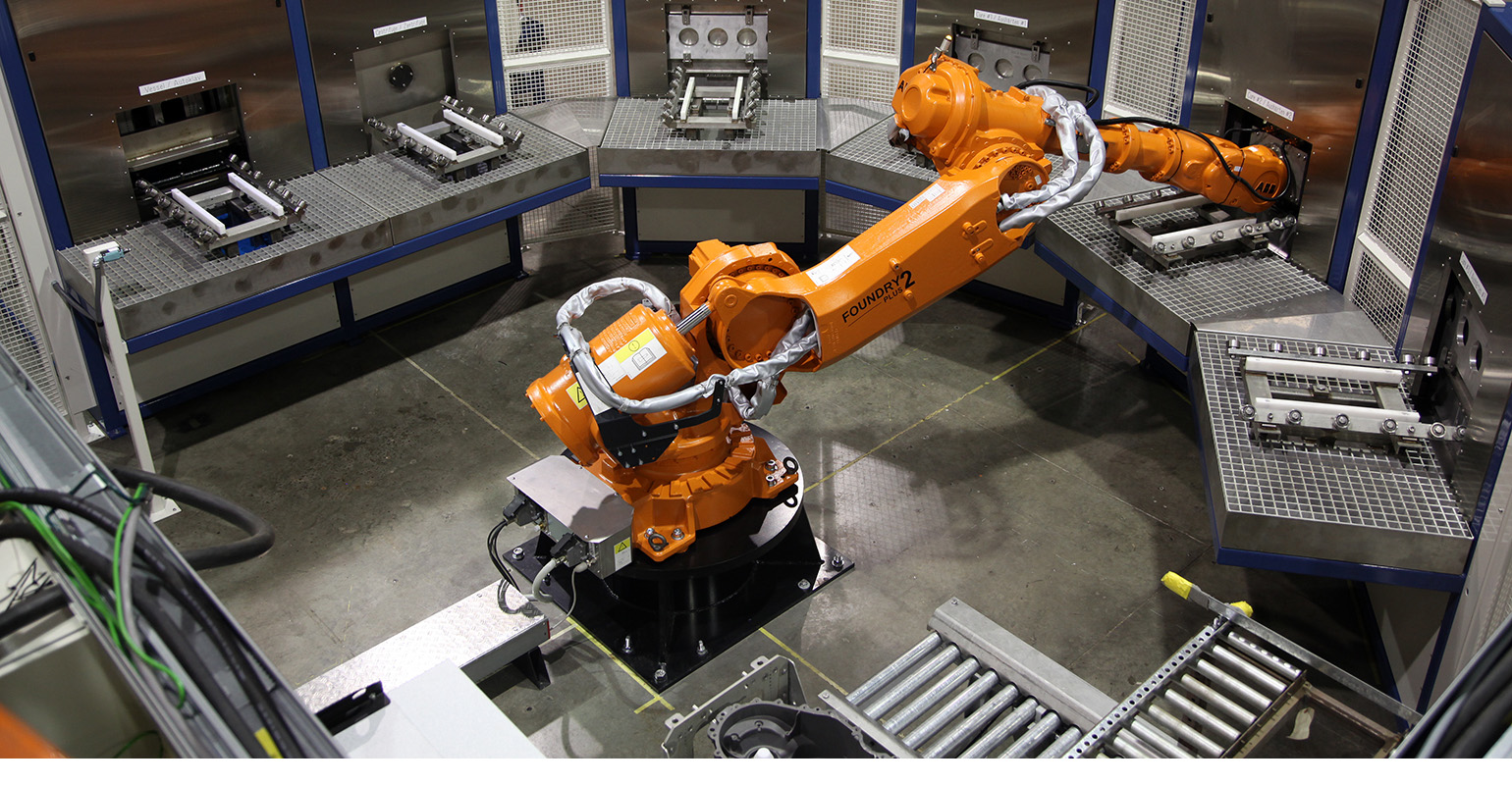

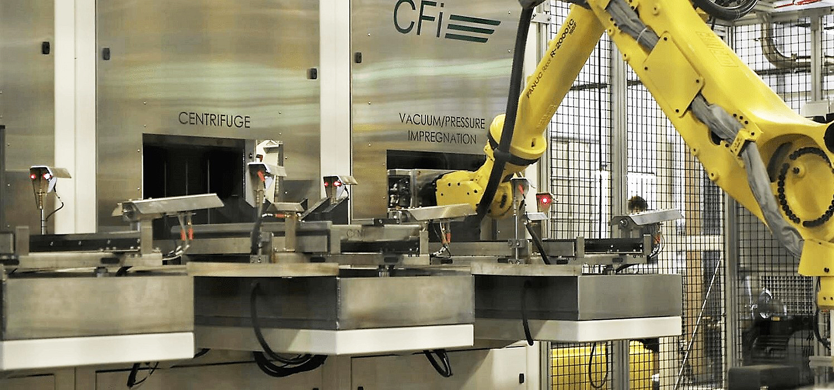

But, the company had standardized on the Godfrey & Wing front-loading vacuum impregnation systems. The U.S. plant operated a fully automated, Continuous Flow impregnation (CFi) system and the Mexico plant employed two High Value Low Volume (HVLV) systems. The CFi is a lean, front-loading impregnation system that uses a robot to handle parts and transfers between modules. The HVLV is the same impregnation technology, but uses automated process control and manual material handling.
