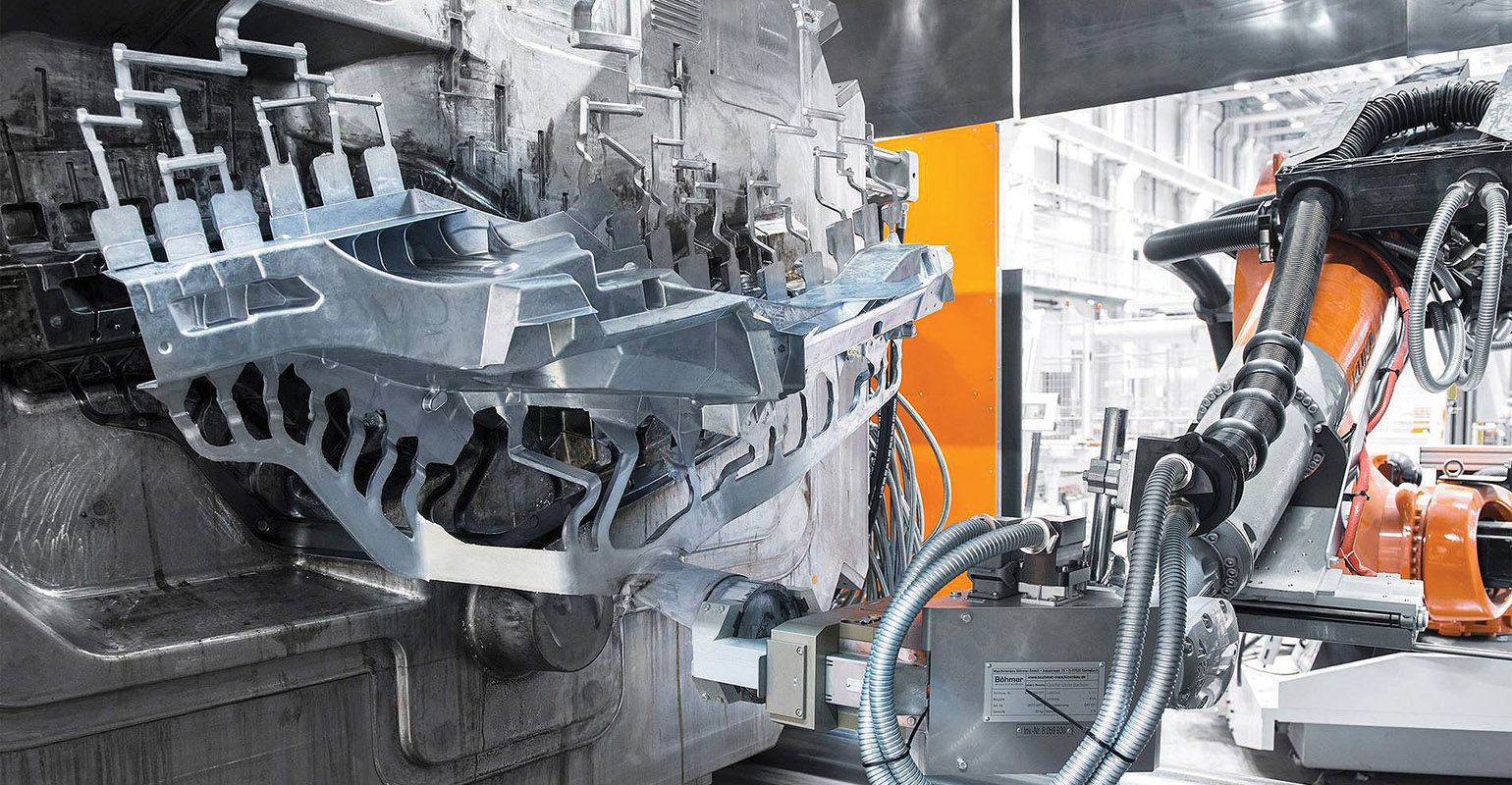

A high-pressure diecasting cell, where lubricants under pressure are used to cool high-value equipment – and workers may be present.

Both fluids protect against fire and the consequential financial losses caused by application downtime, but choosing which to adopt primarily comes down to the specific needs of the application. For example, in applications where workers are present – for example, diecasting work cells – the uncompromising fire resistance of HFC often is favored. While in applications free of any human presence, such as a blast furnace, the enhanced system reliability offered by HFDu will generally drive decision-making.
