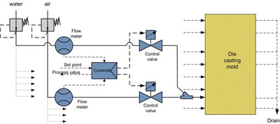

Mold temperature control is critical for maintaining the pressure in the chamber during cooling. Temperature channels just below the surface of the die cavity dissipate the heat effectively, and ensure relatively even temperatures in the mold. The shape of the workpiece and the heat transfer fluid determine the design of the cooling channels and the maximum possible mold temperature. If it’s necessary to dissipate large amounts of heat quickly, water or a water/air mixture is the preferred coolant (see Figure 1.)
Fig. 1: The principle of air/water cooling for diecasting tools.
The number, design and arrangement of the cooling channels in a diecasting mold are important for successful temperature regulation. Specifically, numerous small channels will achieve more precise temperature control than a few large holes. Standard diecasting systems generally provide five to 30 cooling channels for each mold, but there are designs with up to 100 cooling channels. However, the temperature of the coolant and the flow rate are critical for precise and reliable temperature control.
Several independent and parallel cooling circuits ensure more precise control of the cooling process, which improves the quality of the diecast parts. The recent development of proportional solenoid valves makes it possible to apply multi-loop parallel-working flow rate regulation circuits. The advantage lies in the frictionless bearing of the magnetic core ensured by specially formed springs that avoid stick-slip effects. This is demonstrated in excellent results with exceptional response sensitivity (0.1% of the final value), minimal reversal errors and excellent regulation performance.
The measuring range of these new proportional solenoid valves is 1:100, which makes it possible to initiate corrective action by adjusting the valves for even slight fluctuations in the flow rate. In combination with the new ultrasonic flow rate sensor, which has a measuring range of 1:200 and starts measuring at 0.06 l/min., it is possible to dose very small and precise flow rates to air flows (see Figure 2.)
