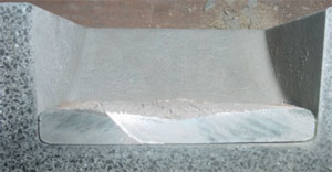

1) Metal button sample, cross-section

Tests of the Altron material that Blasch conducted evaluated the use of cast-zinc button samples, as well as dross and skimmings from a zinc diecasting manufacturer. Altron cup brick shapes were fabricated for these tests.
As detailed by the developer, zinc melt materials were placed in cup bricks and then fired on a laboratory kiln. The kiln firing schedule was a ramp-up of 100°C/hour to 815°C; followed by a 72-hour hold; then cooling down to room temperature at 100°C/ hour. The fired cup brick samples were sectioned using a diamond tipped blade.
As shown in the photo series, no melt infiltration occurred with any of the three zinc melt samples. All three types of melt materials were easily removed from the cup brick surface, either by hand or during sectioning, as seen the photos of the dross and metal button sections separated from the cup brick samples.
