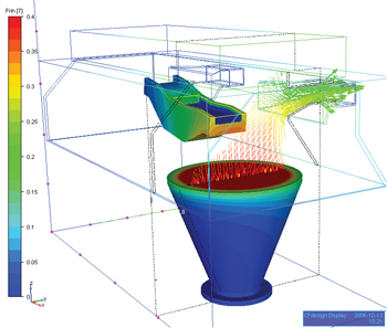

Computational fluid design allowed the project developers to simulate the air flow rates for the tilting runner duct.

Simulations generated by CFdesign software accurately predicted performance of Severstal North America’s new casthouse emissioncontrol system in early design stages. This image is one simulation of the air flow at the furnace taphole.
After setting up the geometry in MicroStation, the model was meshed in CFdesign, which provides built-in tools for simulating the conditions that the new equipment and structure would face. For the casthouse model, we needed to simulate the temperature and velocity of incoming air; temperature, velocity, fume and combustion components associated with the casting and pouring of hot metal; and air flow rates for the tilting runner duct, taphole hoods and slag pot shanty duct.

Each time a simulation was run, CFdesign performed a series of complex calculations and then compared those to determine the degree to which they agreed. Then, the software automatically adjusted the model and reran the simulation to achieve close convergence for small subsections in terms of temperature, velocities and other parameters. It required 225 to 250 iterations of each model to achieve convergence and calculate a valid capture efficiency.

Capture efficiency for the casthouse model was computed as the probability that a fume particle generated at each source (taphole, tilter or slag shanty) would be captured by each hood and subsequently drawn through the ductwork to the bag house. The next – and most important – step in the calculation was to determine fume capture percentages for each individual operation.
The entire study entailed dozens of CFD simulations to arrive at an optimal mix of hood configurations and ventilation volumes. A summary of the key results from CFdesign is shown in table. In addition to numerical results, CFdesign provided static and dynamic images that created a better understanding of what was occurring during the simulations.
