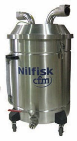

The Nilfisk CFM Immersion Separator is designed to be installed upstream from a vacuum, to trap and retain aluminum and magnesium dust (and other explosive dusts particulates) in a neutralizing fluid bath.

Nilfisk Industrial Vacuum is offering CFM Immersion Separator as an extension of its explosion-proof vacuum line. It is used in conjunction with CFM-brand vacuum cleaners. It is designed to be installed upstream from the vacuum, where it collects dust particles common to Group E in a neutralizing fluid bath.
The new CFM Immersion Separator is assembled from low-sparking materials and grounded components, and features a grounding strap as an additional safety measure. The drain valve is easy to empty, and a sight-level tube makes it simple for operators to monitor liquid levels. The unit is set on antistatic wheels, making it easy to maneuver. Coalescent filters are installed to prevent the passage of fluid droplets that have been agitated by the working air from passing back into the vacuum.
