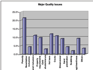

Fig. 1. Major castng quality issues in aluminum, gray iron, ductile iron, and steel castings, based on 121 responses to questionnaire. According to a survey of 121 product engineers, design engineers, metallurgists, laboratory ...
According to a survey of 121 product engineers, design engineers, metallurgists, laboratory personnel, and others associated with the design, production, and use of castings, the metalcasting industry’s greatest need for improvement lies in eliminating porosity in castings. By consensus, this applies to aluminum, gray iron, and ductile iron, and to all types of steel castings. The distribution of quality issues based on this broad survey is shown in Figure 1. Concerns over porosity rated twice as high as any other issue in the survey.
