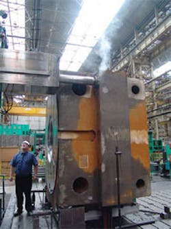

Machining may take up to 1,000 hours for some structural components, so the choice and application of the cutting tools is critical to the success of the project.
A 90-metric ton steel casting being machined at Davy Markham, in Sheffield, England.
This 350-metric ton press component requires as much as 1,000 hours of machining time, making the time-savings achievable with Ceratizit milling cutters particularly valuable.

“Initially we saw an opportunity to develop the existing process,” states Adrian Eagle, Ceratizit’s cutting tool account manager. “The original milling cutters were designed as a double-negative cutter, which is not ideal for a finishing operation. Therefore, we designed a cutter with a 45° approach angle and a positive rake. The effect this had was to improve cutting data on the 250-mm diameter cutters dramatically.”
The feed rate was immediately increased from 400 mm/min to 1,200 mm/min, with the potential to take this even higher, and all this with only one tool. This finishing cutter can be applied for the typical average medium cuts at Davy Markham (depth of cut up 6-8 mm), then a finishing operation at 0.1 mm follows.
