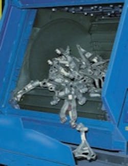

After analyzing how upstream operations affect the blast requirement, the next step is selecting the type of cleaning process, i.e. batch, continuous in line, or individual part cleaning. Common batch machines types include tumblasts, spinner hangers, and tables. An advantage of batch cleaning is that blast times can be adjusted for different casting configurations to provide single-cycle cleaning in most requirements. Occasionally, in table blast operations, castings will be flipped and cleaned in two cycles.
Tumblasts are the most efficient batch cleaning method, provided castings can be tumbled without damage. Automated load and unload operations significantly enhance the productivity of foundry tumblast operations. Spinner hangers are popular for cleaning safety-critical castings, as well as many other casting types that are prone to breakage if tumbled. Tables are normally used for large castings or any castings that cannot be tumbled and are not easy to chain or fixture for cleaning in a spinner hanger.
