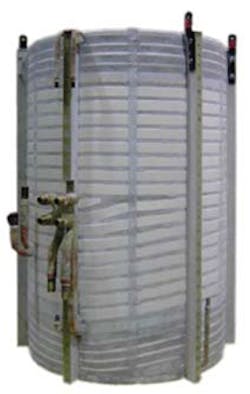

In particular, Stevers cites the furnace coil’s heavy copper tubing, durable Inducto-flex™ coil insulation and the strong furnace structure. “The heavy copper tubing is locked into position by the rigid coil supports and surrounding furnace steel shell,” he explains. “This keeps the coil from flexing and losing its shape. Also, the tough insulating coating on the coil helps protect it against arcing. I’ve always had excellent service life from Inductotherm coils and the new Inducto-flex insulation has enhanced their trouble-free operation.”

“We perform a visual inspection of every furnace at the beginning of each shift,” says Stevers. “We tighten the tie rods as often as needed, or if the inspection indicates that they may need to be tightened. The major things we look for during daily inspection is any difference in the top cap that would indicate that a tie rod had come loose or had broken. We have found that if the top cast ring is held in place, the coil tends not to grow and affect the integrity of the coil.”
