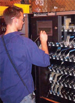

Helix-style vending machines are situated near the production machinery. Authorized employees scan a badge, and the machine dispenses the approved quantity of tooling needed for the job.

The first step in the process improvement was to bring the tools closer to the production area. J.L. French chose CribMaster Toolboxes, electronically controlled helix-style vending machines. These point-of-use devices were placed on the shop floor near the diecasting machinery. An authorized employee approaches the Toolbox, scans his/her badge, and the machine dispenses the approved quantity needed for the job. CribMaster automatically tracks who took the product, how much was taken, and the time of the transaction.
