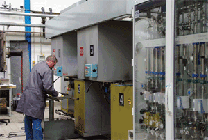

In a new alternative to carburizing, an integrated control device manages dosing of liquid methanol (rather than endothermic gas) and optimizes the differential pressure to maintain the chemical composition for an effective and efficient heat treating process.

One new development in heat treating is an alternative to hardening steel by nitrogen-methanol carburizing. It was developed by Brkert Fluid Control Systems (www.burkert.co.uk) and researched and tested the Institute for Materials Engineering (IWT) in Bremen, Germany.

In the new carburizing process, liquid methanol rather than endothermic gas is introduced directly to a furnace and the solution is regulated using the Brkert LFC. The advantages are that the dosing of methanol is precise and transparent, with the dosage levels, consumption, and flow values measured and documented so they can be reproduced with reliability.
Methanol is cheaper than endothermic gas and easy to store, and it can be fed into the furnace in exact measurements, according to the process requirement. In addition, there are no investment or operating costs for an endothermic gas generator. Brkert maintains its method is more energy efficient, too.
In the ITW test at Bremen, the Brkert LFC automatically controls methanol dosing, reacting to disturbance variables like pressure (such as fluctuations in pump pressure upstream of the LFC, or in the pipe downstream of the LFC) and dynamically adjusts the methanol dosage to maintain a constant mixture. The high-precision measuring capability and adjustment keeps operating costs low and guarantees optimal efficiency, according to the developer.
