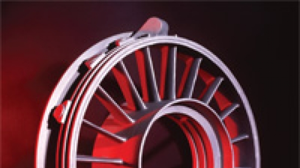

An air-intake guide ring, an example of the titanium castings produced by Doncasters.

Aerospace castings, such as this compressor part, are among the complex shapes demolded and cleaned by the system.
