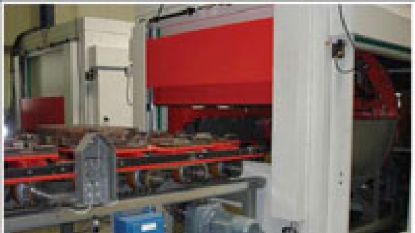

At Technocast, cylinder heads are cleaned of mold and core sand in an automated system of four fully enclosed cells, served by shuttle cars. The units close around the castings, and then administer high-frequency, low-amplitude vibration followed by air cleaning to remove sand from the complex structures.

The success of this project rests on maximizing the value of each casting produced. Foundry Solutions & Design recognized that fact in its approach to designing and implementing the decoring operation at Technocast. FS&D did the concept planning, engineering, and system integration for the automated handling, decoring, and finishing of Technocast’s various cylinder heads. The decoring cells were manufactured by the R. Scheuchl GmbH, and use high-frequency, low-amplitude transducers for decoring to break up hardened sand, followed by a rotating unit to remove sand from the cylinder heads’ internal passages.
FS&D’s president Ralph Perkul emphasizes that the installation involves the best available technology for the task: high-impact systems may damage the thin-walled castings, but the short-stroke, high-frequency method will not. FS&D has been designing similar systems for the past five years, always starting with computer modeling to anticipate any inherent problems, but choosing proven equipment to ensure the operations are effective and consistent.
Scheuchl’s decoring method is based on high-frequency, vertical oscillation of the casting, with amplitudes up to 36 mm. Inside the product, core fragments are broken up by concussive energy, and a subsequent sand-air mixture is removed by high-frequency rotation.
As detailed by Perkul the Technocast decoring station has four fully enclosed cells, and each set of two machines shares a shuttle car with two fixture plates. These fixture plates index to the appropriate position to receive the cylinder heads, then pass the product into the decoring unit. The unit closes around the castings, and a lifting device separates the castings from the loading device. The high-frequency, low-amplitude transducers move into working position, decoring starts. During this phase the cyclinder head is rotated to remove the sand out of the passages, and air is introduced to hasten the sand removal process.
Once the cycle is complete, the unit opens again and a gantry robot moves into position to remove the cleaned cylinder head. Waste sand is transported away by a conveyor running beneath the line.
