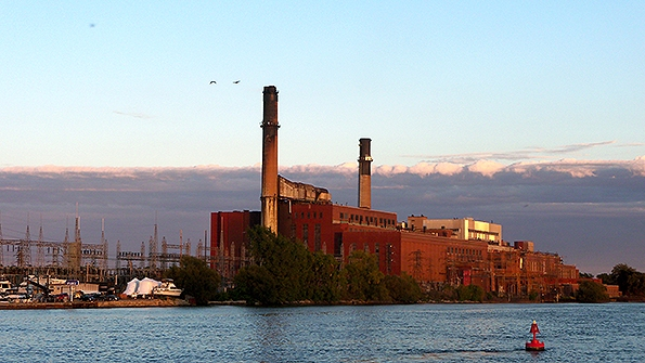

Tonawanda Coke produces coke — a high-carbon material produced from metallurgical coal — in a 60-oven battery, at an expansive plant site on the Niagara River. In January, a Tonawanda Coke employee was pulled into the rotating shaft of a coal elevator as he prepared to grease and lubricate the machinery. The man’s jacket was caught, pulling him onto the rotating shaft.
OSHA determined that his death could have been prevented because the employer neither shut down the elevator nor locked out its power source, as required by OSHA's hazardous energy-control, or lock-out/tag-out, standard. OSHA also found that Tonawanda Coke failed to train employees on how to use energy-control procedures.
"Training employees on lock-out procedures and ensuring those procedures are used would have prevented this needless loss of a worker's life," stated Michael Scime, OSHA's Buffalo Area Director. "Compounding this tragedy is the disturbing fact that OSHA cited Tonawanda Coke in the past for not following the requirements of the lock-out standard. Yet, the company exposed both the victim and another employee who greased and lubricated plant equipment to these same hazards. This is unacceptable. It is Tonawanda Coke's responsibility to eliminate these hazards once and for all and protect its employees."
Following the January inspection, OSHA determined that Tonawanda Coke failed to ensure the shut down of power sources for the coal elevator and a machine in the coke-plant battery, and that energy-isolation devices had lock-out devices affixed. It also failed to guard projecting shafts and bolts on the coal elevator against employee contact.
As to the repeat violations, OSHA noted that Tonawanda Coke failed to provide authorized employees with hazardous energy-control training, and to inform them of the location of energy control devices. It stated that the employer failed to conduct and certify an inspection of energy-control procedures, and to ensure the full lock-out of an energy control device.  Also, it failed to maintain working surfaces in a clean and dry condition, and to ensure to fully bolt covers of electrical disconnects used in a classified location.
