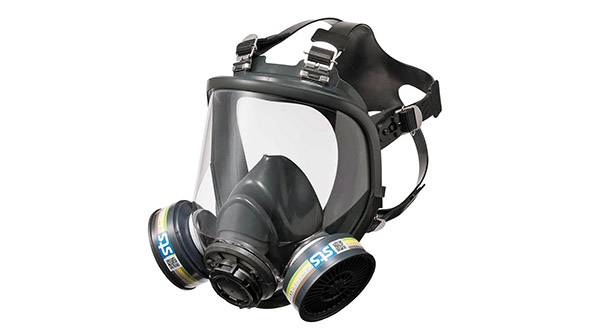

After the inspection, OSHA concluded that the foundry failed to provide respirators, adequate protective clothing, and training to safeguard workers from lead exposure. It also cited the company for not providing respiratory protection; using compressed air to blow lead dust off clothing; and failing to notify a company laundering workers' clothing of the potential for lead exposure.
In addition, OSHA said Martin Foundry allowed workers to eat and drink in areas where lead was present, and failed to provide shower facilities for employees to remove lead dust and particulates before leaving the workplace.
