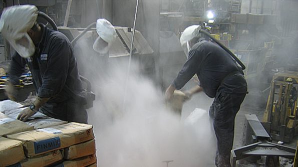

The federal Occupational Health and Safety Administration charged an Ohio foundry with one willful and 17 serious safety and health violations concerning “dangerous noise levels” and silica dust. The agency announced that workers at MCM Precision Castings Inc. were exposed to dangerously high noise levels and crystalline silica dust, and that an OSHA inspection last July discovered that the foundry had not conducted noise testing, nor monitored workers’ exposure to the noise and dust, nor provided suitable protective equipment.

The serious violations cited at MCM involved workers exposed to silica and other respirable dust in excess of levels allowed during an eight-hour period. OSHA inspectors claim the foundry allowed silica dust to accumulate and failed to implement a respiratory protection program to limit workers’ exposure. It said the company also failed to train employees about hazards and provided inadequate protective equipment.
Finally, OSHA claims that MCM did not protect workers from dangerous machinery, that machines lacked effective guarding, and that improper lockout/tagout procedures were used to ensure machines were turned off before maintenance. It also found electrical safety violations and unsafe practices related to forklift operations.
