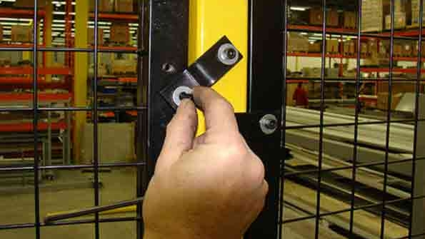

OSHA issues specific standards for machine guarding in general industry as well as other industrial sectors Domestic Castingrsquos recent citations for machine guarding violations were among 12 lsquorepeatrsquo violations it having been cited for similar hazards in 2011 2012 and 2013 the federal agency stated
