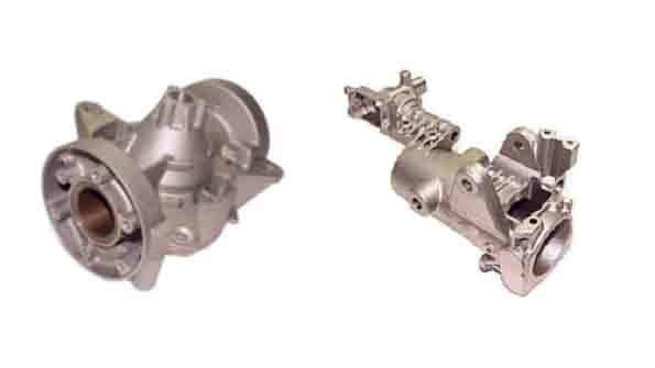

C amp H Die Casting is an ISO 90012008 and 169492009 certified manufacturer of highpressure aluminum diecastings for automotive eg a steering tube right HVAC twocylinder compressor frame right diesel engine and other industrial markets
