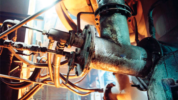

APCOS technology is a tuyere-based system that operates in conjunction with a cupola’s current oxygen injection system. It uses a proprietary burner design that injects supersonic oxygen and natural gas to release energy in the melt zone to replace coke and/or increase production. Experience has shown that there is an ~10% gain in efficiency when adding energy directly to the melt zone. Consequently, 1 BTU added via APCOS technology reduces coke requirement by ~1.1 BTU. Furthermore, the ability to add heat directly to the melt zone facilitates the substitution of coal for a portion of the remaining coke charge.

While injecting oxygen and natural gas into a cupola to reduce fuel costs has proven to be successful, the degree of benefit is inherently limited by the water vapor produced via combustion of methane. Specifically, the water vapor produced from the oxygen-natural gas reaction gasifies a portion of the coke via endothermic (i.e., energy-consuming) reactions. To mitigate this effect, Air Products recently developed the next generation of the APCOS offering, APCOS II technology, which operates primarily with high-carbon, low-hydrogen solid fuel instead of natural gas, thereby substantially reducing water vapor production in the cupola.
The APCOS II system increases the potential for coke savings by eliminating a source of coke loss via gasification. Moreover, since the amount of endothermic gasification is reduced, more energy is available for melting iron. As summarized in Figure 5, the potential for increased available energy and reduced coke consumption improves with the amount of solid fuel delivered from the APCOS II burners relative to oxy-gas firing. The
economic benefit of these savings can be substantial. For example, assuming 10 MMBtu/hr of APCOS II energy delivery, coke consumption would decrease by as much as 500 lb/hr over and above savings already delivered by APCOS technology (see Figure 2). For coke priced at $500/ton, this correlates to an additional savings of approximately $1 million/year of operation.
Due to the high-velocity operating conditions of the APCOS II burner, the solid fuel must be heated, ignited, and combusted within milliseconds of leaving the burner. To guarantee stability and efficiency of this process, a natural-gas pilot is part of the patented APCOS II design. The robustness of the new technology was validated during development via testing of a variety of solid fuels, including coke breeze, petroleum coke, and waste anthracite. A convenient feature of the burner design is that it is capable of operating at its designed firing rate with either natural gas or solid fuel. Consequently, if some disruption occurs in the supply of solid fuel, the burners can be switched over to operate with natural gas with the push of a button. Photos of the APCOS II burner operating in both the solid fuel and gaseous fuel modes are presented in Figures 6 and 7, respectively.
