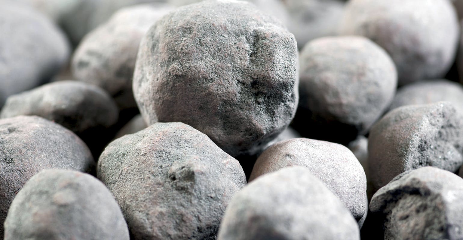

The GreenIron process begins with preparing the raw materials – ore (e.g., magnetite, hematite, wustite), slag, mill scale, filter dust, roasted pyrite, grinding swarf, various tailings, or other oxidized metals. This material is agglomerated using lignin, molasses, bentonite clay, or similar binder, and then pelletized or briquetted in a cold-forming step. The shape of these pellets will ensure proper hydrogen gas flow through the material once they reach the heating and reduction sequence.
After the pellets have been preheated to around 550 °C the batch is placed in a bell furnace, and flushed with an atmosphere of nitrogen gas (N2) that is then evacuated, to draw out any oxygen in the furnace chamber. Hot hydrogen gas (H2) is introduced, and the reduction process begins.
According to the developers, the reduction process works as a result of changes in gravity, temperature, and pressure, and its only by-product is water. The final material is sponge iron/DRI, a high-grade metal typically defined as 91-93% iron that can be stored and shipped safely.
