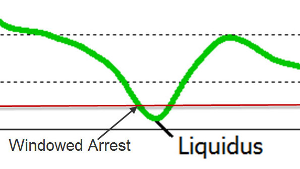

The rate of cooling curve demonstrates how the older "window" system would detect the arrest based on when the rate of cooling fell under 0.5 degrees per second. Modern systems use derivatives to pick the lowest rate of cooling. This results in more consistent measurements.

Thermal Analysis Accuracy — The last part of thermal analysis is accuracy. Not all thermal analysis instruments have the same degree of accuracy. Part of the accuracy is due to calibration, but much of it is due to the instrument itself. Inexpensive instruments have different ways of determining arrests. The early boxes used a technique called “windowing.” If the change in temperature over several seconds was less than a given value, that point was considered an arrest. This technique depended heavily on the amount of metal in the cup, and if any air was blowing on the cup. As you can see below, no two samples will have the same cooling rate for the liquidus, so setting an arbitrary cooling rate to call liquidus builds inaccuracy into the system. The more modern system finds the minimum cooling rate (green) for the liquidus arrest.

The liquidus is the determining measurement for Carbon Equivalent (C.E.) and is part of the calculation for carbon and silicon. The C.E. accuracy depends on the accuracy of the temperature calibration and variation in the chemistry of the wire used in the cups. All major manufacturers use wire that is +/- 2° F. MINCO, now part of Electro-Nite, did report the bias value of their wire on each box of cups, which allowed a 90% correction for any variation in the wire. It is not known whether that will continue with the merger of the two companies.
