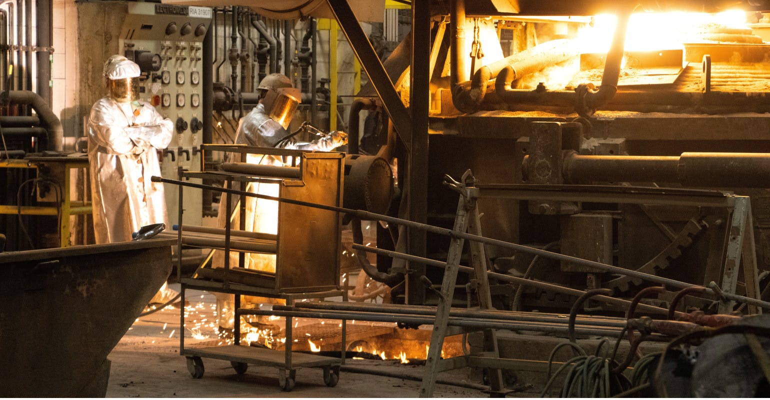

The U.S. Army’s Rock Island Arsenal-Joint Manufacturing and Technology Center reported it completed the largest pour of molten metal in at least two decades – 7,125 lbs. or more than 3.5 tons – on June 6, at the manufacturing center in Rock Island, IL. The completed casting consists of 16 separate pieces that form a “pintle system” for a Pennsylvania lock and dam project by the U.S. Army Corps of Engineers.
“This is a proud moment for all of us at RIA-JMTC,” said Jamie Morris, division chief of hot metals. “Producing such a massive part required precise coordination, advanced technology, and a relentless commitment to quality. This achievement is a testament to our team’s skill and dedication.”
Each of the 16 parts was formed from printed sand molds, also produced at RIA-JMTC. The foundry pours a wide range of metals, including nonferrous and specialty alloys.
According to RIA-JMTC, the casting project involved eight days for printing all the mold components necessary for the mold, culminating in this significant accomplishment.
