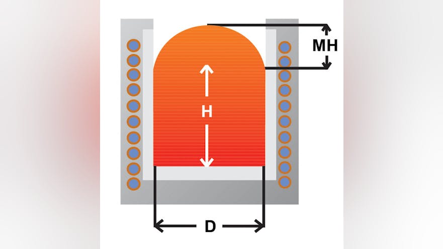

Figure 1.
Metal stirring in a coreless induction furnace had been little understood until research undertaken at Inductotherm in the mid-1970s established the science behind the stirring forces. Up until that time it had been thought that inductive stirring in an induction furnace was related linearly to the meniscus height in the furnace. This linear relationship is described in Figure 1.
Figure 2.
Meniscus height varies directly with kilowatts and inversely with the square root of frequency. However, in actual melting operations it became apparent that this simplistic approach was not an accurate measure of stirring. Furnaces containing the same amount of the same metal, but running at different frequencies, did not stir the same even though the meniscus heights were identical.
