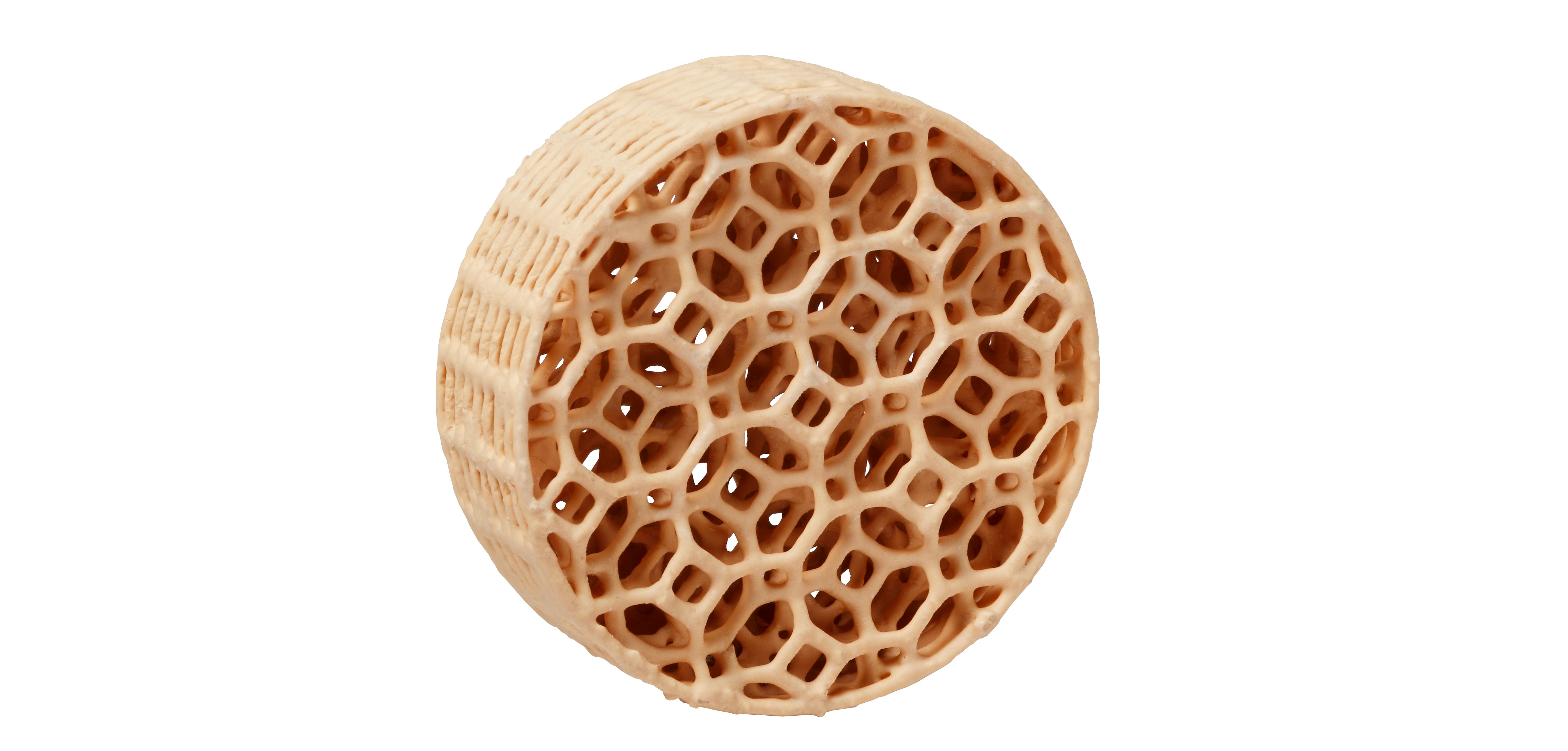

The solution for effectively preventing filter bits and at the same time ensuring the repeatability of the filter structures is to manufacture filters using suitable 3D printing processes. The advantage of this process is obvious: exact reproducibility. Once the structure of the filter is available as a CAD file, clean geometries are available and can always be reproduced exactly as designed. The 3D-printed filter (Fig. 5) represents a new quality of reproducibility. Each printed filter is identical to the previously printed one, and the next filter will be exactly the same. This significantly improves process reliability.

EXACTPORE 3D filters avoid filter bits and make possible a significant increase in flow capacity compared to standard filters. The free design options and scaling possibilities allow entirely new approaches in the production of filters. Previously, the cast part and casting technology were adapted to the filter: now, the filter can be adapted to the special requirements of the casting.

A medium-sized steel foundry presented the EXACTPORE filters with a challenge. The requirement was to improve the filter efficiency by increasing the capacities and flow rates with at least the same filtration effect (compared to the standard foam ceramic filters commonly used) by using printed filters (see Fig. 7.)
To maximize the significance of the planned test, various filter sizes and melt quantities were combined. Above all, however, castings were selected that are produced in large quantities and with the comparable standard foam-ceramic filter in order to have a good basis for comparison.
Two filter sizes are used: rounds, with a diameter of 75 mm and a thickness of 25 mm in 10 PPI; and squares with dimensions of 150x150x30 mm in 10 PPI. Both filter types were partially stabilized zirconium-oxide.
Using 3D-printed EXACTPORE filters resulted in 33% and 38% reductions in post-processing effort, compared to the conventional foam ceramic filters used by the foundry – clearly a significant economic advantage.
