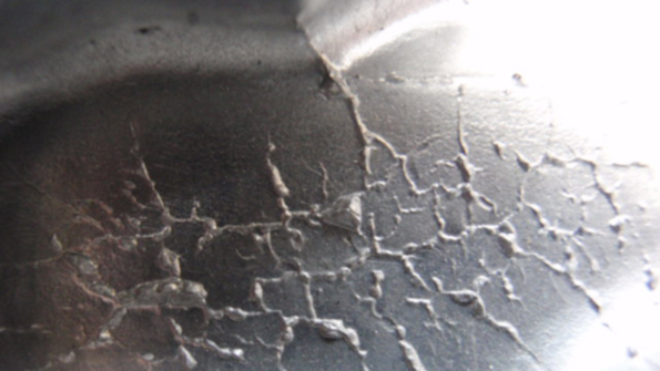

Eliminating water from the die spray lubricant will extend die life by cutting the possibility of die cracking see above as well as porosity in the diecastings

The savings mainly arise because Lubrolene WFR can be applied at much higher temperatures than conventional water-based lubricants, which are only effective between 150°C and 250°C (300-500°F.) As a result there is less thermal stress on dies, compared to water-based die release agents, which extends the service life of the dies significantly – another source of substantial savings.
