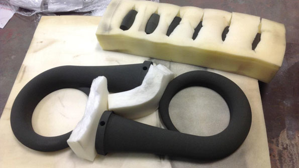

3Dprinted volute cores

Humtown has also seen the benefits from 3D printing of plastic for core gluing fixtures. Using Humtowns’ FARO arm 3D measuring device, measurements of an existing pattern were taken to create a core gluing fixture that holds the cores in place for assembly and gluing. The fixtures were printed out of complex shapes that made it simple for the core finishers, and could not have been manufactured for the same cost by the conventional method.

Core gluing fixture.
