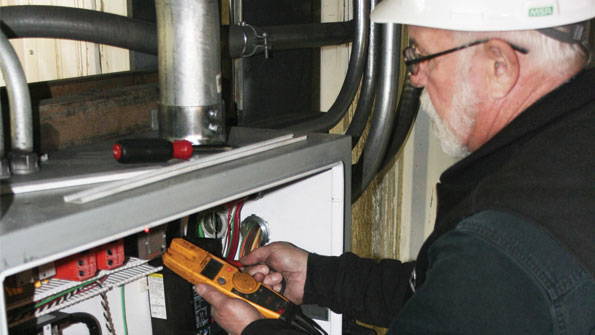

Used machinery may be mechanically sound but with controls that need to be updated completely for the machine to function correctly and to integrate to a plantwide operating system.

Many times a machine is mechanically sound but the controls need to be updated completely, not only for the machine to function correctly but also to integrate to the plantwide operating system. Controls (and programming) in general can be quite expensive.
