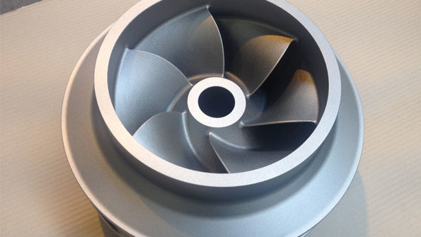

Steel impellers up to 1m in diameter produced by the Replicast process are correctly balanced with high dimensional accuracy and superior surface finish meaning the total cost of ownership is improved considerably for the pumpsrsquo operator

Cti has advanced the Replicast process so that it can produce impellers that have inherently challenging narrow passageways that are critical to a pump’s operation. As a result, the casting process can be used now to produce impellers that are correctly balanced, up to a meter in diameter, with high dimensional accuracy and superior surface finish.
According to the process experts, it seemed at first that the lower cost of impellers made using more common casting processes limited demand for Replicast impellers. However, that is changing following recent process optimization: the cost of producing the impellers has been reduced by around 30%, which is shifting the focus among pump users and manufacturers toward the total cost of pump ownership and ‘up time’ (i.e., the time available in service, rather than in repair or replacement.)
According to Cti, at least one manufacturer is focusing now on a casting’s purchase cost, versus how much it costs them to buy a raw casting, process it, and install it in a pump. The switch makes Cti’s impellers far more attractive since they have significantly lower (even zero) non-conformance costs, require little or no "detailing," and far less finish machining, thanks to the near-net-shape process.
Because Replicast uses ceramic shells formed around sacrificial replica patterns, made directly from CAD designs using additive manufacturing technologies or machined from polystyrene, the accuracy of each casting is exceptionally reliable. Tests have shown that pumps using Replicast impellers are 10% more efficient than impellers made by traditional methods, which means pumps can be smaller, reducing material and manufacturing costs even further.
