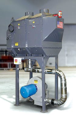

Palmer Manufacturingrsquos HCCLSeries sand classifier system has four major components a base or plenum chamber into which fluidizing air is supplied by a blower a fluidizing deck a heat exchanger bundle and a main body which serves as a cover and pressure chamber

Many foundry managers and operators wonder about the possibility and/or effectiveness of removing airborne sand fines by using a fluid bed classifier. The following summary will help anyone to troubleshoot the sand classification process to increase fines removal.
Removing sand fines through the classifier depends on several process details, namely 1) dwell time; 2) fluidizing air volume; and 3) exhaust negative pressure in the head space.
Dwell time — The sand in a fluid-bed system resembles any liquid in a vessel. The faster that fluid is poured into the vessel, the faster the fluid will overflow. The dwell time in a fluid-bed classifier is determined by the rate that sand flows into the classifier. The inlet sand opening – butterfly or slidegate – regulates the flow of sand into the classifier.

Generally, classifiers have 4-ft.-high expansion chambers immediately above the classifier exhaust connections. The diameter of these chambers is sized to reduce the exhaust air to a velocity of approximately 750 feet per minute, allowing the coarser sand grains to drop back into the classifier.

Fluidizing air volume — The design element that controls the volume of fluidizing air is the open area of the blower inlet blast gate. Plugged filters on the blower inlet also will reduce the fluidizing air. Individual blast gates below individual modules can redirect the flow of fluidizing air, or stop it completely if totally closed. Once the classifier is filled with sand and the filters are clean, the inlet blast gate usually is adjusted until the sand is bubbling about 6 inches in each module. Some adjustment of the blast gates below each module may be necessary to get even bubbling in modular systems. The sand must be at nearly the same depth throughout the length of the classifier for the bubbling to be uniform.

Once all modules are bubbling properly it is necessary to adjust the exhaust using the blast gates above the expansion chambers. These blast gates should be adjusted so that there is some measured negative pressure in the headspace. Generally, a negative 0.6 inches of water column is acceptable for silica sand. Higher-density sands may require a higher negative pressure. Higher negative pressures will remove more fines.
