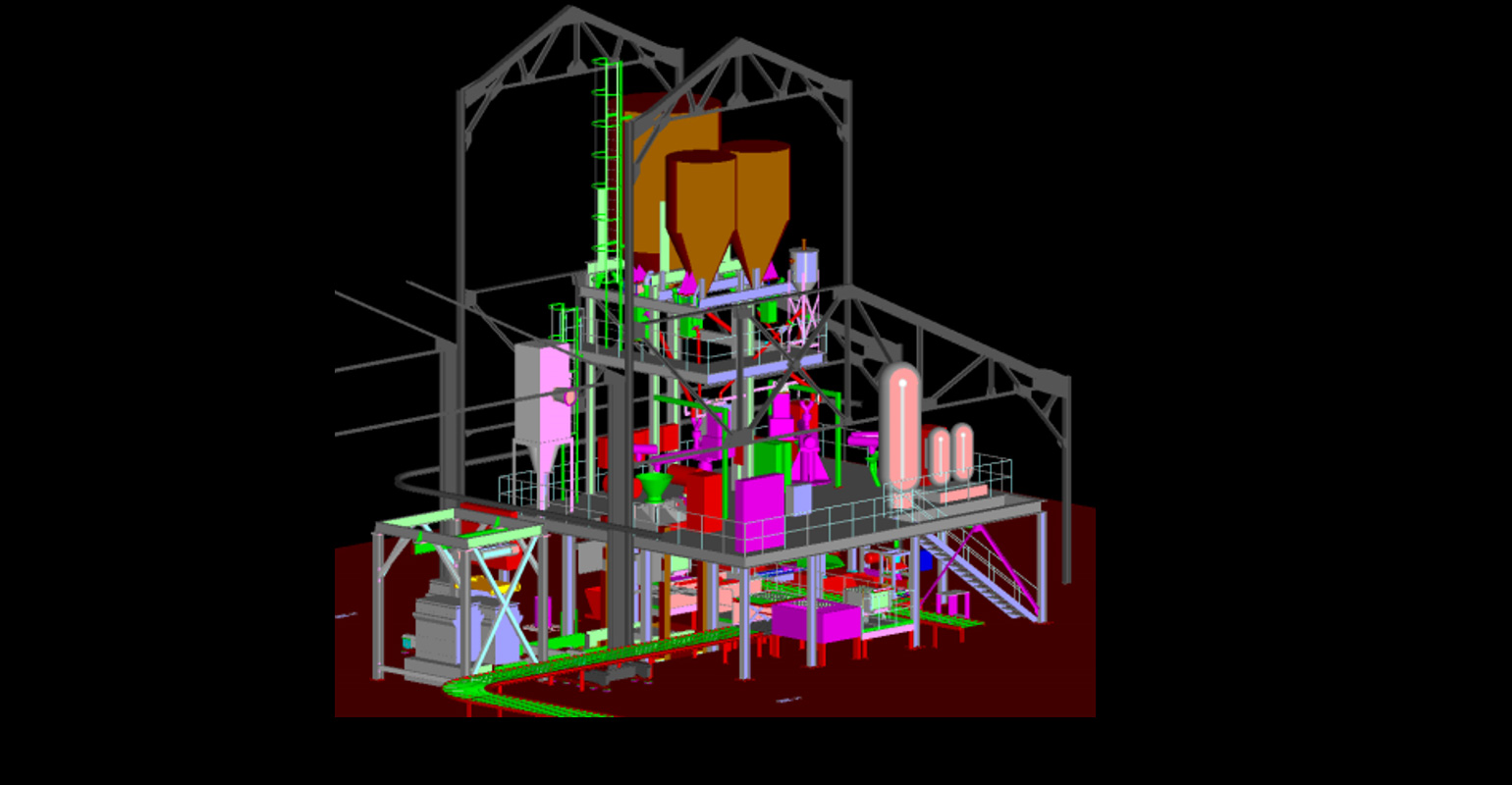

EMI core system CAD illustration

These are the key components of a core cell system. Many more items go into your specific solution to complete the core room plan. Once that plan is complete, the engineering design, build, location and installation are all critical. Before you finalize your Gantt chart, you will need to consult local or state laws for proper permits, as obtaining installation permits may take over six months.
