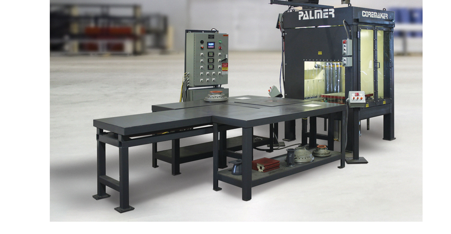

The Palmer CM coremaking system can producecores up to about 50 lbs. in about 60 seconds.

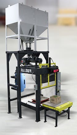

We developed a series of no-bake core blowers and box-handling systems with capacities up to 650 lbs. (295 Kg) to address this specific problem. There are a few items to note when comparing the production cold-box to no-bake chemically bonded cores. First, it’s important that managers realize that it will not be efficient to make one box over and over quickly – this normally results in wasted sand since the set time is made as quick as possible resulting in plugged blow chambers and cores that set up before fully compacted or filled. It’s somewhat counterintuitive, but when making no-bake blown cores, the set time needs to be comparatively long – maybe 3-4 minutes. A number of core boxes can be processed at the same time. This can be accomplished with either a turntable or conveyor next to the machine. One operator stays at the core maker and does nothing but refresh the blow chamber, move boxes into place, blow, and then remove the core box from the machine and get ready for the next core box.
A series of core boxes with a total weight of slightly less than the blow-chamber capacity can be fed to the machine, and blown until the chamber is empty as long as the work time is longer than the required time to blow the succession of boxes. Then the small amount of residual sand can be purged from the chamber. New sand can be run right on top of the residual sand if the work time is sufficient. An operator can move a box in, raise and clamp, blow, lower and unclamp in 30 seconds. The blow chamber can be refilled as the next box is prepared.
The art of this efficient and speedy process is not as much in blowing as it is in manually removing the core from the box. The core is ejected mechanically from most cold-box machines. The operator lifts off the core, or swings in a hoist or core picker for larger parts. With unmounted chemically bonded cores the box needs to be manipulated for quick, safe, and ergonomically correct removal. Obviously, this is case specific but there are many labor saving devices like tool balancers, etc., that make this efficient. The key is that the box is not in the machine – it is external to the machine. While the previous boxes are being stripped, more cores are being blown. Normally, with one operator for the coremaker and one at the removal station, cores up to about 50 lbs. can be produced every 60 seconds. Larger cores will require more time to lay down, remove the box half, remove the core, replace the box half, stand the box up, and return it to the blow machine.
