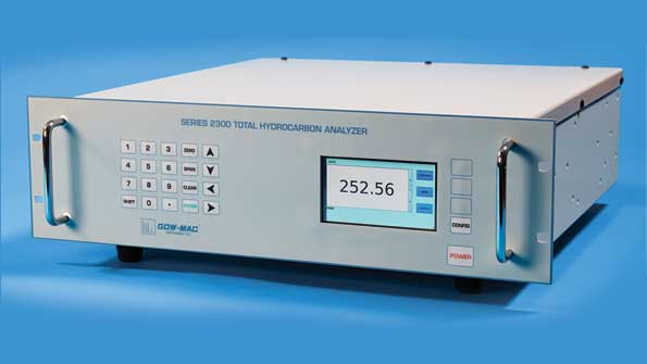

GOW-MAC INSTRUMENT CO., a manufacturer of gas analysis instrumentation and compressed gas handling equipment, introduced the Series 2300 Total Hydrocarbon Analyzer, a microprocessor-controlled instrument designed to measure concentrations of hydrocarbons continuously using an optional catalytic methanizer, CO, and CO2 in gas streams.
The Series 2300 employs a flame ionization detector (FID) where ionized carbon atoms are produced when burned in a hydrogen flame. The ionized atoms are detected by the instrument and displayed as a concentration in ppm or ppb on an LCD.
A high-resolution graphical LCD touchscreen accompanied with a membrane keypad allows straightforward navigation through settings and functions.
Engineered to operate on either zero grade H2, a 40/60% H2/N2 or a 40/60% H2/He fuel mix, the instrument features auto ranging from 0.00 ppm to 20,000 ppm; auto zero and auto calibration; programmable relays for concentration alarms, events and diagnostics; electronic flow control of air, fuel, and sample gas; real-time data logging; a flame-out indicator with auto shut-off of gases for safety; and a full array of optional output capabilities, i.e., 4-20 mA, VDC [0-1 V, 0-1 mV, 0-10 V], RS-232, RS-485, USB, and Ethernet, along with MODBUS and PROFINET [read only] communication protocols.
Samples can be introduced by an optional internal pump or by pressurized tanks.
