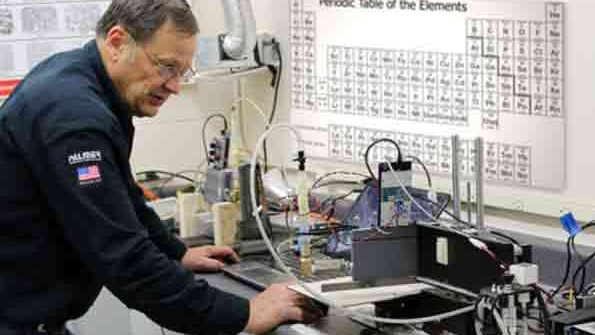

The first Viridis3D RAM10 materials development kit was installed for sandbinder research projects at Palmer Manufacturing amp Supply Springfield OH

The first system was installed earlier this year at Palmer Manufacturing & Supply, Springfield OH.  “It was extremely easy and fast to get the RAM10 up and running. With a little guidance form Viridis3D, we had a new ink working in just a few days,” according to Palmer’s technical sales/service manager Ken Strausbaugh, who deployed the RAM10 system to conduct research into sand binder performance.
