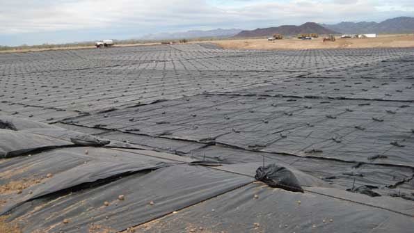

TRC Companies, a Lowell, MA, engineering, consulting and construction management firm has earned a National Recognition Award from the American Council of Engineering Companies for its effort to demonstrate the effectiveness of using spent sand from iron casting foundries as a landfill liner.
Working with Wisconsin Foundry Inc. to reduce landfill costs and reuse foundry byproducts, TRC determined that properly hydrated and compacted, bentonite-laden sands can be used safely and effectively as a low water permeability barrier product.
Wisconsin Foundry owns and operates a non-hazardous waste disposal facility in Waupaca, Wis., that receives spent sand from three green-sand foundries in the region producing gray and ductile iron castings. The sands contain silica, trace metallic elements, and bentonite clay, and customarily had been sent to the non-hazardous landfill.
TRC and WFI constructed test pads using the sand byproduct as landfill liner material. Their demonstration of how to effectively use the spent sand as a barrier in the landfill liner system was approved by the Wisconsin Department of Natural Resources in May 2014
TRC explained that the reuse of the sand byproduct reduces WFI’s landfill waste deposits by 80,000 cubic yards. Also, the design of the landfill liner using the byproduct reduces liner requirements from four feet of clay to two feet of sand byproduct material, overlaid by a geomembrane.
