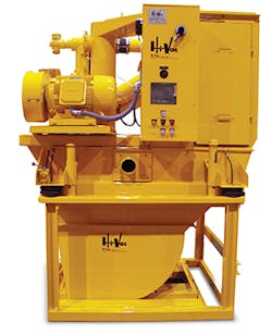

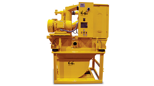

In terms of cost, safety, effectiveness, and efficiency, the best answer now is an industrial vacuum system. In particular, the manufacturers should recognize the effectiveness of an industrial vacuum system that vents cleaned air back into the atmosphere, versus systems that vent polluted air outside of the plant. Note that once air leaves the building, the EPA can join OSHA in regulating the operation.
It is also important to make sure that the system will be easy to use. Employees already have to make significant adjustments to their operating practices”. Adding more detail or stress to the situation will not help achieve anyone’s near-term or long-term goals.
Several manufacturers make reliable industrial vacuum systems. When searching for the perfect system, one of the most important things to determine is the air-to-cloth ratio. This detail will signify how effective the system may be at pulling particulates out of the air.
Also, determine what material the filters are made of and how tightly pleated those filters are. Gore-Tex filters can capture the smallest particulates, while other materials may not be able to work at the same level of precision. Moreover, if the filter is tightly pleated it will not work as effectively as a filter with wider pleats.
Make sure the system you select offers important safety features like a broken-bag safety shutdown, low blower oil safety shutdown, and high vacuum pump temperature safety shutdown.
Investing in such a wholesale change to an operation will be intimidating, of course, but there are some positive aspects to weigh, too. Leasing options are available for these types of systems, including some as low as $750/month. Additionally, even if these cleaning changes were not mandated, an industrial vacuum system would save plant operators a lot of time and a lot of labor. Where previously one or two people would be responsible for sweeping and the shoveling, an industrial vacuum system connected to a central manifold system cleans continuously with very little effort on the part of your staff.
