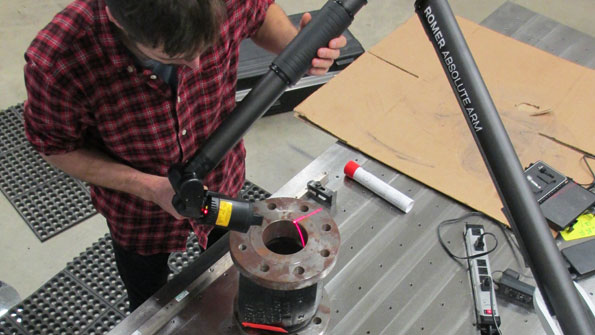

With a portable CMM arm PCMM and laptop on the shop floor parts can be scanned with the data points sent upstream for instant analysis comparison to the CAD file the CAM program comparable machines in the shop producing the same or similar parts and other actions in an information stream

Enter “metrology,” which simply refers to the systematic and highly precise gathering of data in time and space. A part can be fixtured, scanned, and swapped out on a work table next to the machine or, in the most advanced production machining centers, in-process on the actual work table of the machine tool, using highly controlled robots for both part articulation and probing. Today’s CNC can even run these robotics on a second channel of the control, from a remote pendant, so the operator becomes both machinist and CMM operator simultaneously.
And so, now the fun begins.  All these data points, which are gathered by the reflection of the light beam and captured in the software of the scanner, can be instantly sent over a communication bus to a host computer in the QC department. There, the points are compared to the CAD file, the CAM file is recalculated or the CNC can do it on the machine in-process (very new technology there) and the machine makes the very next part to the correct spec, altering the cutting parameters to offset the thermal or tool wear conditions or even the machine kinematics.

Scanning modes vary: Laser scanners are typically mounted on a robotic armature with an optical scanning system, and can work in an area up to 18 feet in diameter and produce data at a rate of nearly 500,000 points per second
White/blue light scanners, mounted on a tripod or robot, capture more than 18,000,000 points per second. In a single shot, white light scanning can take measurements in an area from less then a square inch to several square feet.
CT scanning allows measurement of internal structures of parts by generating a voxel cloud from a number of two-dimensional x-ray pictures, which can be converted to point cloud data
Resolution on all these technologies is today as tight as 0.0005 in. Combined with the accuracy, which rivals all current CMM technologies, laser and white light scanning are perfect for micro to large machined parts. When the advantages of a portable CMM (PCMM) are needed, the laser scanner is simply replaced with a touch probe on the robot arm with optical trackers. This gives the shop the benefits of both high-density scanning and high-precision point measurement on the same part.
