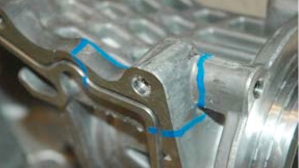

Blue paint outlines the areas of material andor structural vulnerability in an aluminum casting

Schradin’s CT scan project — conducted Exact Metrology Inc. for the OEM buyer of that aluminum casting — represented the first use of CT scanning for metrology in U.S. manufacturing.
A series of CT scans revealed the voids designed into the cast part, as well as the weak areas and surface defects.

The OEM customer was interested in wall thickness inspection as well as the porosity of the cast material, and void analysis. Areas under stress, where leaking or breaking was suspected, were highlighted for inspection. Schradin’s scans helped to distinguish legitimate voids designed into the casting from areas where serious design or material problems may be occurring.
