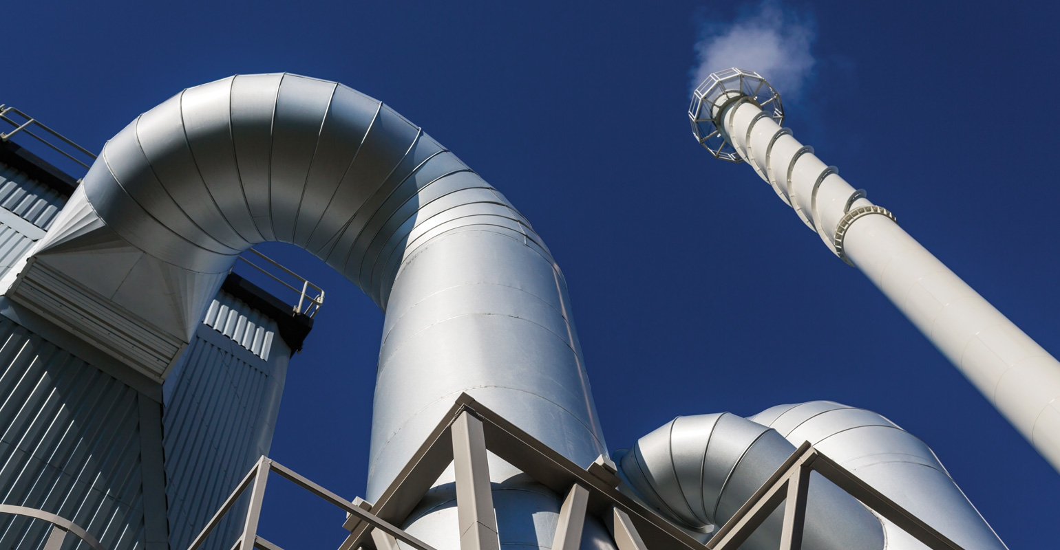

Energy-efficiency is not a hard-sell to manufacturers, so why are there not more proponents for cogeneration?
