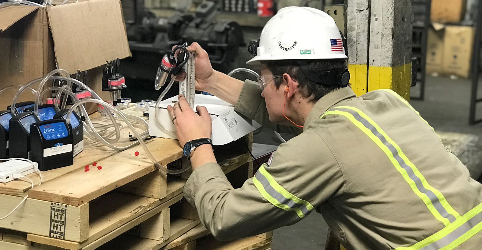

Once the sampling plan has been developed and approved by the plant’s operations, engineering, environmental, and safety teams, as well as the industrial hygienist, a sampling protocol should be selected. At this point it is important to note that the industrial hygienist should specify the appropriate sampling and analysis protocols, some of which are specifically referenced by the standard. The sampling techniques should incorporate appropriate quality control methods and the samples should be analyzed by a laboratory that follows the analysis methodologies specified in the standard.
The most common mistake that we observe during this step is plants’ failure to adhere precisely to the protocol. Some examples of this include failure to place the sampling inlet in the employees’ specified breathing zone; turning “cyclones” upside down at completion of the sampling event; the industrial hygienist’s failure to regularly monitor the sample pumps throughout the event; failure to correctly calibrate air pumps; and failure to accurately record durations.
