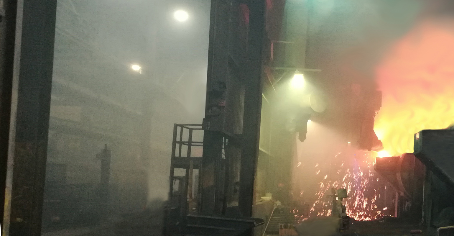

Combustion-sourced sand accumulation in a foundry / Keramida

Another common mistake we see when implementing engineering controls is a failure to properly determine the silica sources. Many employers are very effective in determining employee exposure levels and yet fail to identify where the silica is actually coming from, or moving to, within the facility. We have seen dozens of examples of engineering controls being put in place, sometimes with significant cost to the organization, only to result in little or no reduction in silica-exposure levels. Most often, this is due to the employer seeking to solve the wrong problem. They have relied on “common sense”, “tribal knowledge”, “gut feelings”, “intuition” or other similar methods of evaluation that were not based on accurate data.
This leads back to an earlier (June 2017) report regarding the importance of gathering an accurate and comprehensive data set prior to implementing engineering controls.
Let’s take a look at some actual examples of engineering control failures. Most of these resulted in significant expenditures for the employers, both in time and money.
•  A foundry assumes the primary source of silica is shakeout, which then is isolated, enclosed and ventilated. Only then is it discovered that there is no significant reduction in exposure levels to their employees.
•  A casting cleaning firm installs numerous fans to disperse silica. Rather than the expected reduction in silica levels, the installation results in increased exposure levels for employees.
•  A casting producer installs side-draft hoods in the finishing area. These hoods do not solve the exposure problems, resulting in substantial modifications and additional costs.
•  A foundry cuts holes in makeup-air ductwork high in the foundry, to reduce air pressure. This air could have been redirected to solve other silica issues but instead is being used to distribute respirable silica that has collected on the catwalks and structure throughout the foundry.
•  A foundry installs fans to move air in stagnant areas, but the fans blow over free-falling sand, distributing respirable silica throughout the foundry.
•  A foundry installs additional dust-collection equipment, without additional makeup air. Negative pressure in the building reduces effectiveness of the collection system, resulting in additional costs. Further evaluation determines that a smaller dust collector combined with a makeup air unit would have been more effective and less expensive.
•  A foundry installs collection but does not effectively enclose or hood it, reducing effectiveness.
•  A foundry reallocates collection for new process and is no longer collecting the original process effectively, causing an increase in employee exposure.
•  A foundry collects particulate data instead of silica data: We have over 15 examples of employers who collected extensive data regarding respirable particulate, and used that data to make silica-related decisions, resulting either in no reduction or even increases in employee-exposure levels.
