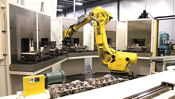

Godfrey & Wing devised its Continuous Flow Impregnation (CFi) system for GM Powertrain as part of a fully automated engine manufacturing line: It can seal a single aluminum cylinder block in less than 98 seconds, a quick and efficient sequence that allows the foundry to integrate impregnation with finish machining, and achieving a First Time Through (FTT) acceptance rate above 99%.
The CFi system takes a single, fully machined cylinder block straight from the production line, and uses the robot to transfer it through the four-stage dry vacuum impregnation process. Along with the robot and a dry vacuum pressure (DVP) impregnation chamber using a low-viscosity sealant, there is a centrifuge to recover surplus sealant, a water wash/rinse stage, and a hot water curing stage that solidifies the sealant inside the casting porosity.
The impregnated cylinder blocks are impervious to the passage of gas or liquids that may cause gas or liquid leakage during service.
The short-cycle time made possible by the robot is important because most foundries have product variations, and must execute set-up changes without loss of productivity.  The CFi system can process individual parts (large castings like engine blocks or heads, or transmission cases) or trays of smaller parts (fuel injection pumps, air conditioning compressors and power steering housings) in just a few seconds. The robot also makes it possible to operate around the clock, maximizing productivity. It operates with no direct labor, which lowers the hours/unit production cost.

Other advantages of robot-centered impregnation processes were revealed at GIFA 2015 once Ultraseal International introduced its R-FL-Duplex+ machine, which performs casting impregnation as a two-step process. It’s also a “small footprint” installation, which addresses the practical concern about incorporating an additional process step in a high-productivity foundry. It’s also designed as a modular operation, scalable up to 45 cycles per hour with the addition of extra vacuum modules.
