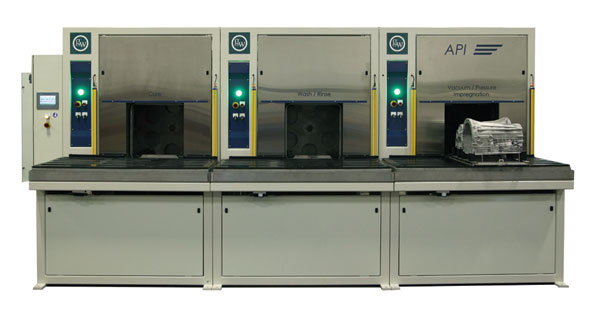

Godfrey amp Wingrsquos new Advanced Powertrain Impregnation system uses a patented dry vacuum and pressure DVP process with a 43 larger work envelope than earlier processes to accommodate larger transmission cases

For plants adopting on-site vacuum impregnation capability, the most notable new technology is from Godfrey & Wing. The Advanced Powertrain Impregnation (APi) system was developed specifically for automotive powertrain manufacturers, the developer noted, but it also is applicable for light- to medium-weight, large-volume part impregnation.
Onsite systems are an increasingly common option for foundries and engine/powertrain plants,
Godfrey & Wing’s APi system uses the same, patented dry vacuum and pressure (DVP) process technology found in GW’s CFi and HVLV impregnation systems, but offers a 43% larger work envelope to accommodate new, larger transmission cases.
“In response to a need in the marketplace for a vacuum impregnation system with the capability to impregnate larger parts, our engineering team developed the APi,” Matt August, G&W’s director of Business Development. “Like the HVLV, the APi is modular in design and is available as either a manual or automated system. The manual system is capable of processing up to 15 cycles per hour, and the automated system can process up to 36 cycles per hour. The separate vessel, rinse and cure modules allow for flexible system configuration.”
The developer said APi “fills a void in the marketplace” and meets the emerging demand for single-piece flow impregnation of large parts.
