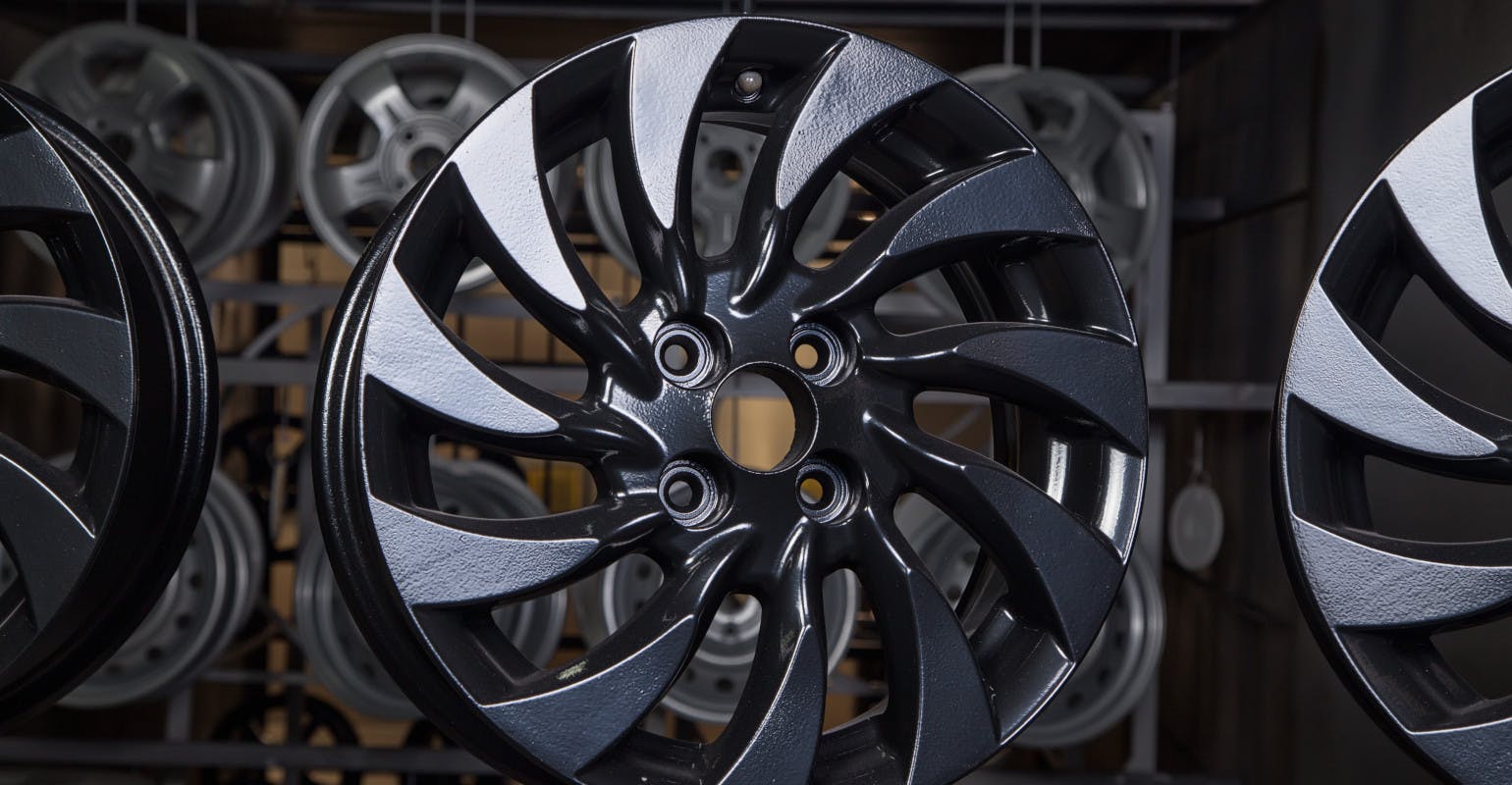

Powder coating offers a durable, long-lasting finish for aluminum wheels.
