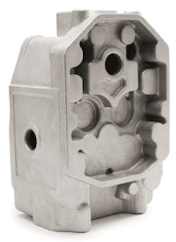

McDaniel explains that RCT basically is a rapid prototyping process that uses printing technology to build up a shape, either a mold or a core. Working from the CAD files, the process creates “slices” of the required mold or core electronically, then builds the mold or core by “printing” the slices one after another.
According to McDaniel, “The base materials that we use match what foundries use exactly. We use silica sand and furan binding systems.” The significant difference is that no tooling is required to form the mold or core.

1. Print — binder is “printed” on a layer of pre-activated sand.
2. New layer — the build platform is lowered by a set increment.
3. Spread — a new layer of premixed sand is spread using a vibrating re-coater system.
4. Repeat — steps 1-3 are repeated until the mold or core is built.
5. Clean and extract — unbound sand is removed effortlessly, using brushes and a vacuum cleaner.

A typical core produced by RCT.
